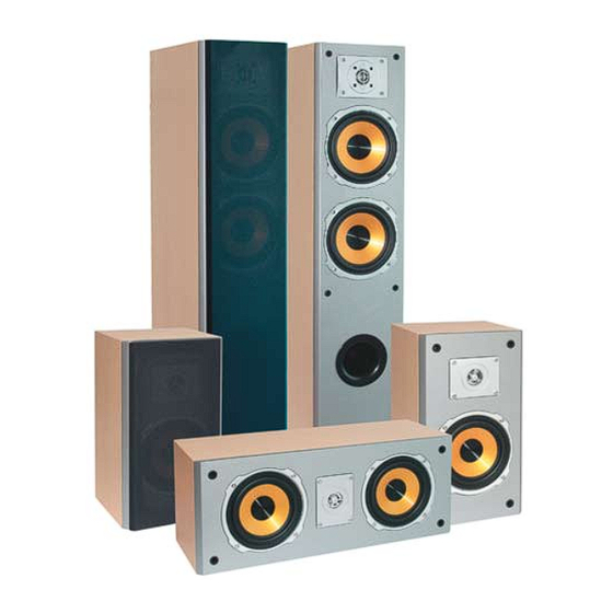

I love your setup. I was using something similar.
I moved to Germany where I could not (and want not) take with me my cheap 5.1 (MDF wood tower speakers from SAL 2610 line)
Here I have 2 old Sony booksheld speaker with a cheap chinese Class D amp.
