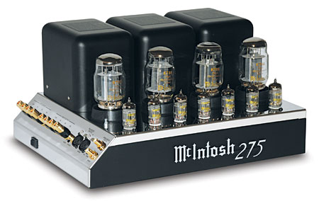

Here is a rather traditional tube power amp that has better measurements. Even it has too much FR variation. Otherwise it is pretty clean. McIntosh did have somewhat different transformers.

The McIntosh amp always reminds me a bit of Harley Davidson in appearance. I can't make friends with that.
I do like classical and would gladly come listen if we were close enough.

Well, beauty is in the eye of the beholder. I wouldn't let it in the house ;)
I rank it in the middle of the third quartile of visual attractiveness for tube amps.
Not competitive, as our host would say.
