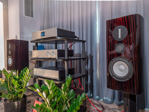

We worked with three editors from Stereophile. We really appreciated their genuine interest and effort to work with us. It started with Rogier met us in our showroom at the 2024 AXPONA:
It was a nice and brief listening experience. The editor who wrote the article is Robert Schryer. John Atkinson did the measurement and auditioned the speaker in his room. So that Piano Ebony BMR Monitor went through three different editors and three different rooms. The final writing comes from Robert and John "independently" (and through the magic of the editor in chief). In between, one binding post was damaged during packaging and it came back to my shop to repair before continuing the review journey. I did not send a replacement speaker. It was the original reviewed speakers after repairs. It crossed USA and Canada borders a few times (I was glad that happened before new tariff rules). That whole process took one year. :)
This Piano Ebony pair reviewed and measured by Stereophile is physically located in Vienna VA. Anyone who wants to audition are welcome.
