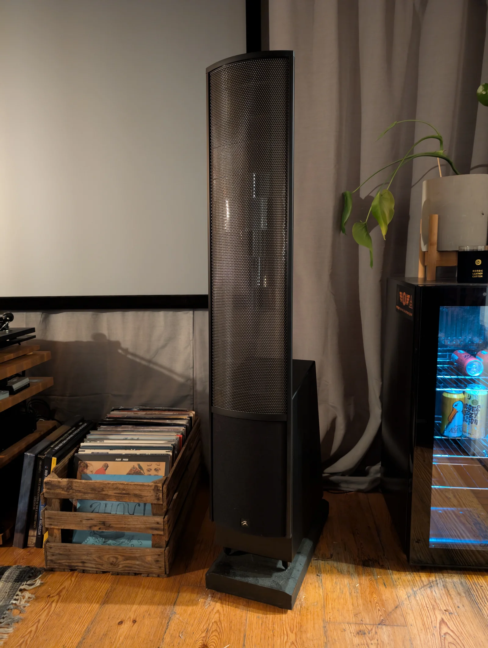

Just to show of what is available in your budget class (thereabouts) on the used market. Admittedly in Sweden but it is probably more or less the same where you live @Jim586music
More if you live in a big city less if....enough said about the obvious.:)
Interesting with a decent selection but it can be a bit confusing because how do you know if any of these could be a good alternative? Taken at random:
Duevels Planets​
Canton Reference 7.2 DC​
Magnepan MG12qr​
Martin Logan ESL​

Since the room is quite large, I would also recommend the Hexo Aurora 1000, or the newer Aurora 700XT and 1000XT, although the difference is mostly cosmetic.
The 700, 700XT, and 1000 should be within your budget, and you can sometimes find them used for a good price.
These floorstanding speakers offer significantly better sound quality than their price range.
