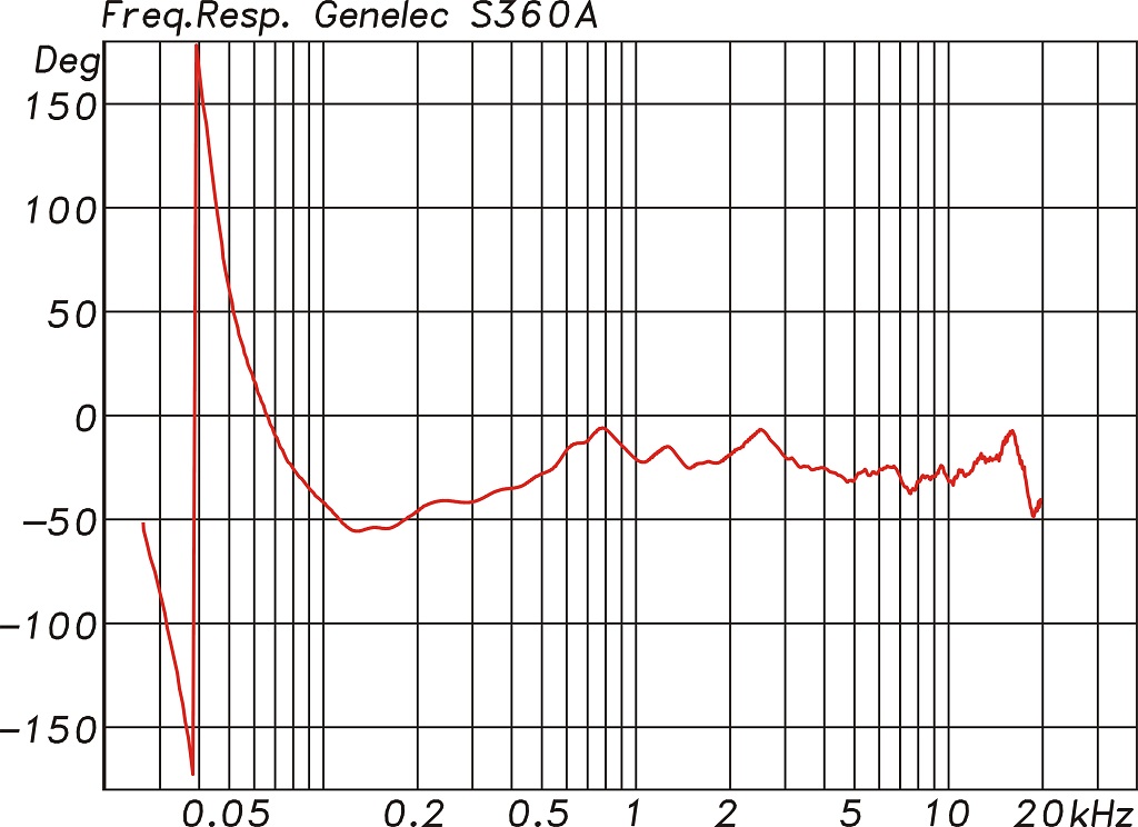

The S360 looks quite clean:
Measure at 10 feet in a typical room and get back to me.
