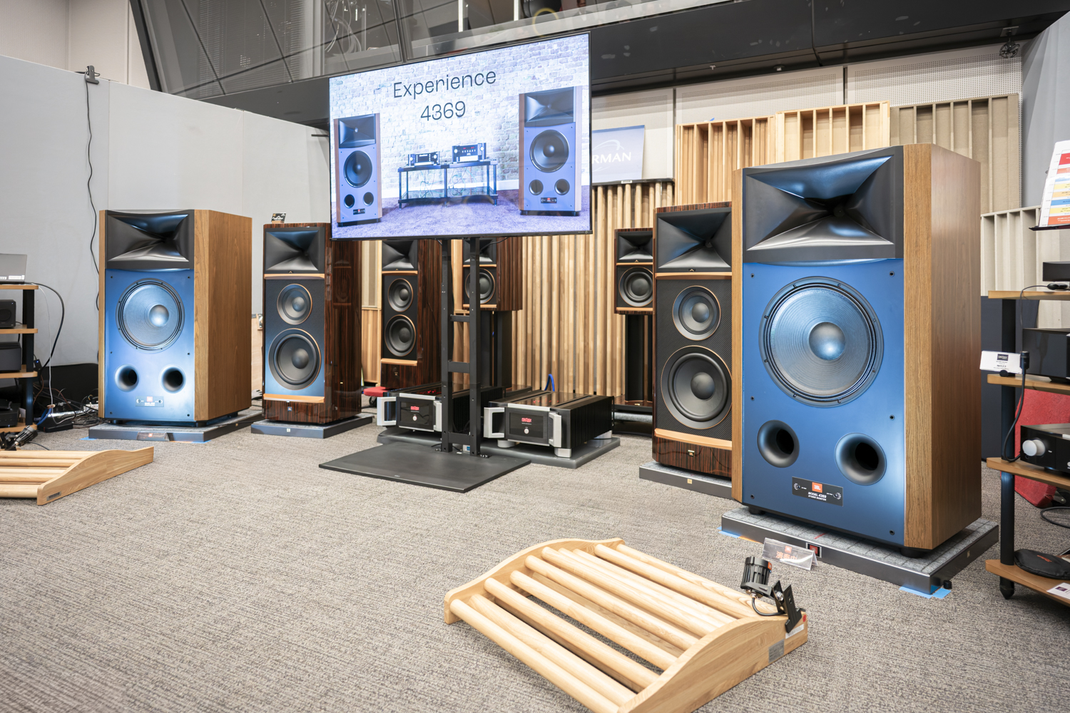

If big woofer is slow, does that mean JBL's new 4369, 2-way with a 15 inch woofer (i.e. big, heavy cone), is never going to give "fast" bass?

The lowest moving mass for a 15" woofer is around 70 grams. To get this mass moving requires a considerable electromotoric force AND time. Just check out the transient response in the availble speaker measurements on different sites and you will see. There are many things and parameters you can play around in driver design, but you cannot trick or ignore inertia.

Compared to what? A 15” woofer will have a totally different bandwidth vs a small woofer. Obviously that will yield a different transient response.
