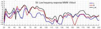

2. Response below Schröder should be measured with both speakers playing, since most audio content is Mono there and the bass response is likely quite different between one speaker playing vs both.
An example:
An example:
Do you mean below Schroeder we should use eq for both speakers together rather than eq them individually. Bit of an issue for Dirac and other room correction software.
Dragging them out from the wall may bring other problems.
You can eq down the peak at 68hz, but you may find that you shouldn't remove it altogether. How high is the peak (dB)?
Yes. At low frequencies, the sum of all contributing sound sources matters.
Measure and correct each individually and the complex sum of all will likely be poor.
This holds true with basic PEQ, not so much with solutions like MSO, Dirac Bass Control, Dirac ART etc.
Both might work, but if you EQ individually you need to measure the sum afterwards to see that the result was actually as expected.
