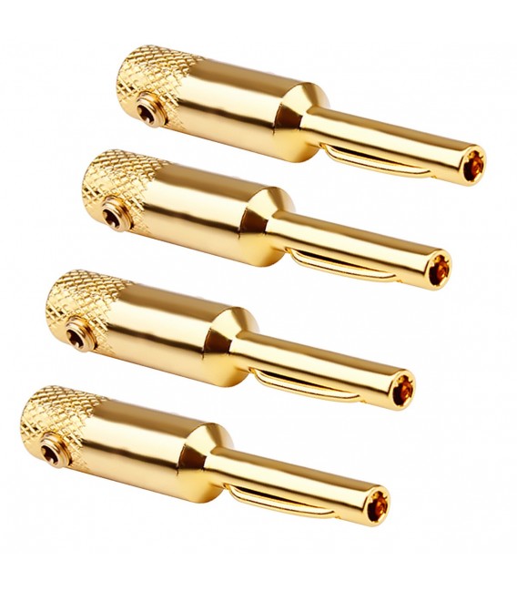

Lads, I recently got hold of some CMC BFA plugs. I went ahead and plugged them into my speaker(Focal) & amplifier(NAD) terminals and found them not going in anything more than about 5mm or so. The plugs have a contact pin/rod in the middle to keep the thin, rolled protruding tube from being deformed or losing its shape if pressed too hard, etc. Strangely, I could get my other hollow BFA plugs into these fully as they should with a little force. I feel that the hard rod-like pin is causing the malleable tube not to narrow when inserted. What do you think I should do? Should I use a pair of pliers and gently squeeze around the tubes to reduce their thickness and allow them to go in easily? Please let me know. Thank you.

The problem is with some female banana plugs, often made in China, which are shorter:
