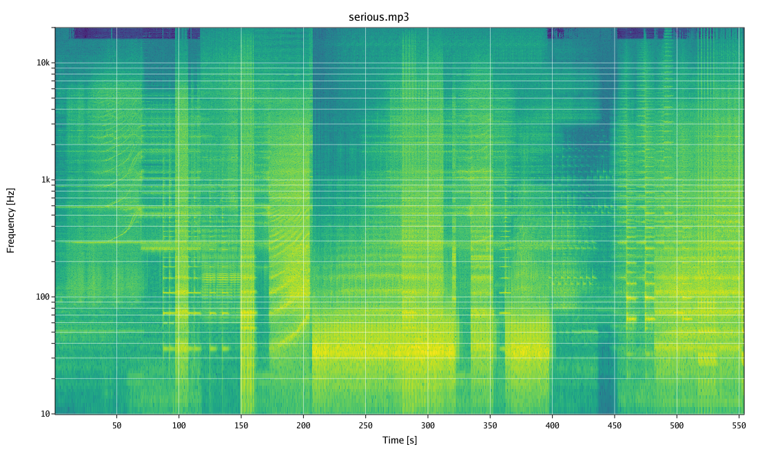

And here's the spectrogram of the song 'Why So Serious?' by Hans Zimmer and James Newton Howard, from the movie 'The Dark Knight':
It is sometimes believed that this song has some "very deep bass", etc. People hear the sound, and begin guessing. But this is the objective reality check. The song has a powerful bass line in the middle, but it's mostly 30 ... 40 Hz, which is not really that deep. Any decent subwoofer will crank it out, no problem.

soundspec -i /path/to/music/folderAnd here's the spectrogram of the song 'Why So Serious?' by Hans Zimmer and James Newton Howard, from the movie 'The Dark Knight':
