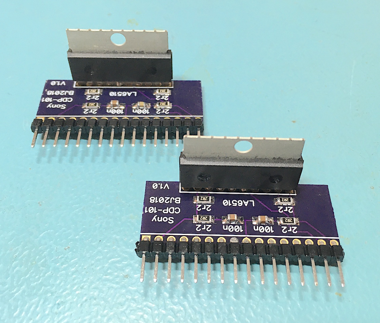

Hopefully just the usual dead/dying focus/tracking servo IC. This one has original 1983 Sony hybrid thick films in it.
Already dug out my bag of LA6510s. LOL. Somebody had made/was selling a nice little PCB a few years back- anybody seen it recently? Wouldn't mind grabbing a bunch.
If so, you may want to check the current consumption of what it's driving, it may suffer from dried-up grease.

I've found the PCB gerbers and ordered some PCBs for the LA6510 boards. So, I'll wait until they arrive as I'll do the replacement in any case. Got plenty of spares for the box of 4x CDP-101s in the storeroom too.
Bram Jacobse has publicly listed the file. (scroll to the bottom)
