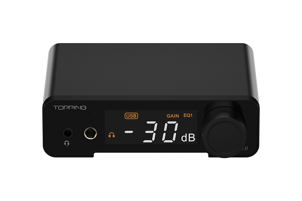

So, I've also received mine today, but I'm really disappointed. I compared DX1 II with my old DX1, and with the same headphone, I see a big difference in power output of SE 3.5 out - same headphone (32Ohm Adam Audio H200) with same Low Gain setting - it is about 90% (-18..-16 dB) for DX1 II and about 50-55% for DX1 volume knob. DX1 max power output is rated as 280 mW @ 32 Ohm, and DX1 II is rated as 510 mW @ 32 Ohm. So I expect to have the same output level for DX1 II low gain as for DX1 high gain, or about 75-80% of DX1 High gain mode. I expect the analog knob in DX1 will not match (digitally regulated ?) volume level setting of DX II, but anyway, low-gain mode in DX1 II should be more powerful and closer to high-gain mode in DX1. Or I'm wrong, and the digitally regulated step has a completely different amplification multiplier? And this "extra" power, for example, can be closer to a 0 dB volume setting? Let me clarify: for the same audio track with the same headphones, my comfort level of loudness for DX1@Low gain is about 50% of the volume knob, and for DX1 II@Low gain, it is about -18dB (~90% of the volume knob setting). Both USB DACs are connected to the MBP 14" with the same audio software.
Did you consider that the DX1 II is a balanced headphone amplifier and delivers only one-quarter of its power at the SE output (3.5mm jack)?
Yes... But we compare rated power output - correct? and DX1 II is rated as 510mW@32Ohm (High gain) and DX1 is rated as 280mW@32Ohm (High gain) for SE. So i can approximate that DX1 II Low gain should be more powerful than DX1 Low gain - is it correct? Or is it possible that DX1 II "Low gain mode" has a different gain setting and is less powerful than DX1? By specification, DX1 Low gain is -2 dB, and DX1 II is -1.6dB, so

Ok, I see - it is look like Exponential Pot Taper vs Linear Decibel Attenuation issue. This vast difference in knob placement is caused by how the Topping DX1 (Gen 1) uses an analog volume potentiometer versus how the Topping DX1 II (Gen 2) uses a precise, digitally controlled volume attenuation system. But maybe possible to improve via a firmware update volume step change? For example, for low level, each step should be 2 or 3 dB because -90..-80 dB looks like a completely useless (First 25-30% of volume knob setting) and useful volume setting starting from about -50 dB (maybe -60dB for low impedance and high sensitive headpones/IEMs). I see that we have 0.5 dB step for high-level volume setting - the last 10 dB till 0 dB. I think from the point of view of UX (user experience), the same idea should apply to the lowest volume settings - i think it is better to scroll faster -90dB -> -80dB -> -70dB -> -60dB (3db (99->70), 2 dB (70->50) -> 1dB(50->10) -> 0.5dB(10->0) steps for example for each range ).
The DX1’s analog knob was probably tuned to have a linear scale, so 50% position was 50% of max volume / power it could produce, but decibels and the volume knob on the DX1 II are logarithmic. We perceive a 10 dB increase in volume as roughly twice as loud, so a lot of the volume / power of the DX1 II is within that final 10 dB of volume. I asked AI “if a device volume ranges from -100 db to 0 db and you set it to -18 db, what perceived percentage of volume is it at?” and it told me 28.7%. 50% volume on the DX1 II should be around -10 dB.
Yes , I understand that mathematically I have more power output , but it less intuitive from UX perspective that 90% volume setting is only 30% of real power output. And about 50% volume knob settings for DX1 - it is around 50 :) maybe it is 55% - it ls something between 12 and 1(13) o’clock. For me its look like similar volume level is something about -18..-15dB if I speak about my usual comfort loudness level
3.5mm output is about equal between DX1 and DX1 II.
Definitely with both in Low gain, where the difference in maximum output is less than 0.5dB
With both in High gain, maximum output is basically identical with high impedance headphones (DX1 II plays 0.5dB louder), but the advantage grows slowly with falling impedance.
At 32Ω, the DX1 II can play 2.5dB or 20% louder, that's it.
The real gain comes from switching to Balanced output.
And, as you've already experienced, analog pots and digital volume encoders behave fundamentally different.
Yes, I see. Basically, for my low-impedance headphone with high sensitivity (Adam Audio H200), I don't need a balanced output - but for my Hifiman 400SE I will use it, of course. I hope Topping developers can tweak the firmware to use 2 or 3 dB steps for low level like -99...-70dB range - same as they did it for range from -10... 0 dB with 0.5 dB for better user experience.
