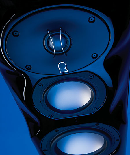

Ok guys... it's been 50 years since my last geometry class, so be gentle. If the dispersion angle of the tweeter is 10 degrees (is this accurate?) and my listening position is 10 feet away, I come up with an ear level of 10.5" above or below the tweeter to be within the on axis range. My Salons aren't here yet, so I can't measure the tweeter height, can someone supply that figure? My ear level is 36", so if the tweeter is 46.5" or lower, I'm "in the zone", otherwise I need to tilt the speaker or raise my position, it to do so. My old math teacher just passed away at 91, so I can't ask him... so I'm asking you guys to check my work and offer either answers or good natured rebuke for my luddite approach... along with answers... lol. The "little grey cells" ain't what they used to be. Thanks.
