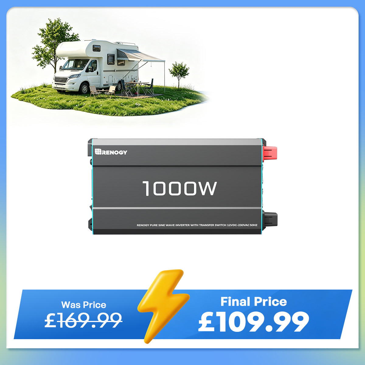

I also tried an inverter:
Interestingly, that gave a similar output to the UPS, around 100mVA.
My question is, is there any device I can get that could lower it down to below 10mVA? Would a UPS with a lithium ion battery work much better?
