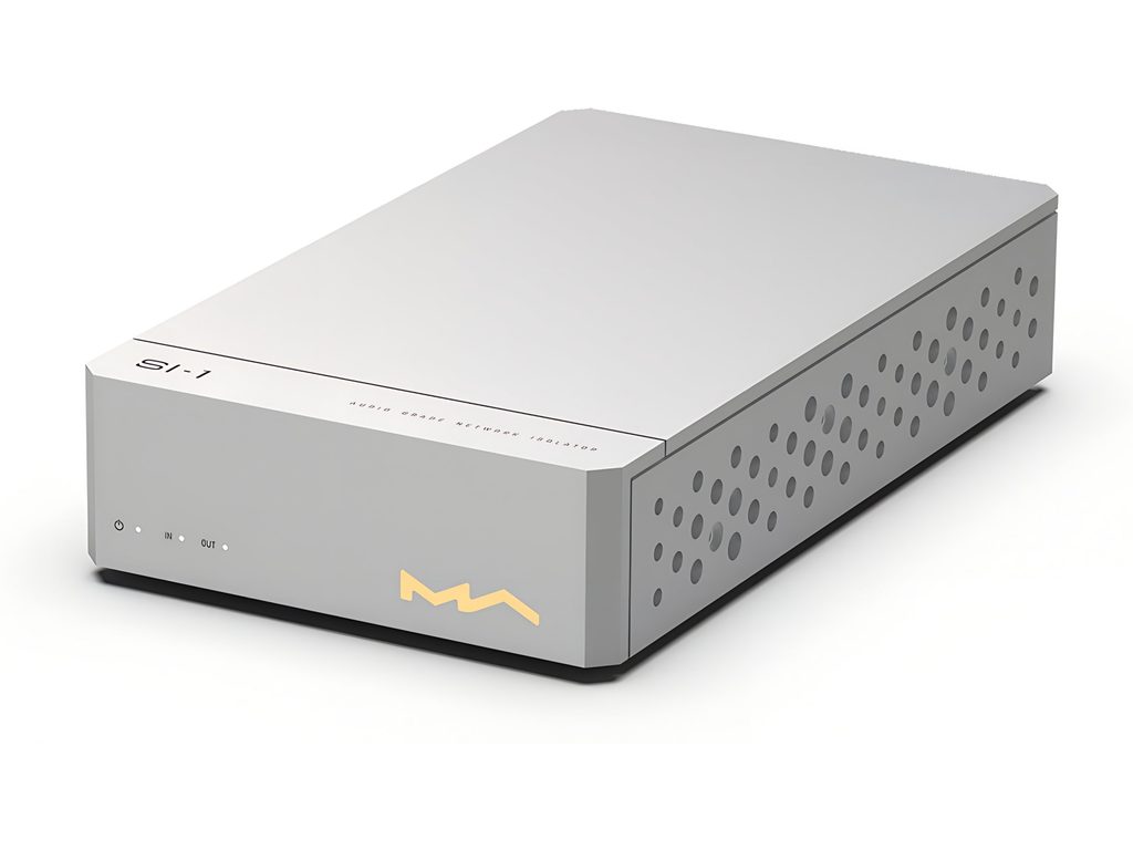

The review from “Ed” doesn’t care, he says this:
“Beautifully built, so very solid and easy to install. The SI-1 is connected directly between my router and my streamer. Strong musical improvement of the audio signal. Wider soundstage, blacker background, excellent instrument placement, and more detail. Best Ethernet filter I have ever had.”
What is nice these days, anyone can check all those specs and claims through AI:
The product description for the Matrix Audio SI-1 relies heavily on audiophile pseudo-science - taking legitimate engineering principles (like galvanic isolation, jitter reduction, and low-noise power supplies) and misapplying them to asynchronous digital networking, where they have no practical impact on sound quality.
Here is an objective, step-by-step technical breakdown of every major claim made in the text.
1. "Electromagnetic noise, ground loops, and interference travel with the signal to audio conversion stages"
  • The Reality: Standard Ethernet already has galvanic isolation built into the specification by design.
  • Technical Breakdown: The IEEE 802.3 standard requires all standard RJ45 Ethernet ports to use isolation transformers (magnetics). These transformers eliminate DC ground loops and isolate common-mode noise up to 1,500 Volts AC.
  • The Verdict: Ground loops do not travel across standard Ethernet cables unless you use shielded CAT6/7 cables with grounded RJ45 plugs incorrectly connected at both ends. Using simple unshielded twisted pair (UTP) cable gives you built-in galvanic isolation for zero extra cost.
2. "Galvanic isolation via optical fiber cuts electrical links and prevents noise propagation"
  • The Reality: The SI-1 creates a problem, solves it optically, and then re-introduces the exact same problem at the output.
  • Technical Breakdown: The SI-1 converts standard Copper Ethernet \rightarrow Optical \rightarrow Copper Ethernet.
    1. The input side takes an electrical Ethernet signal.
    2. It converts it to light internally over fiber.
    3. It converts that light back into an electrical Ethernet signal to output via an RJ45 port.
  • Because the device connects back to your audio streamer via a copper Ethernet cable, it re-introduces electrical noise right at the output stage. Furthermore, to run these internal conversions, the SI-1 plugs directly into your wall AC outlet—introducing mains leakage current and power-supply noise that wouldn't exist with an off-the-shelf, passive medical-grade Ethernet isolator or standard fiber media converter.
3. "Femtosecond clocks reduce network jitter and timing errors affecting audio reconstruction"
  • The Reality: Network jitter on Ethernet has zero effect on digital audio playback.
    • Network Jitter vs. Audio Jitter: Network jitter refers to minor variations in packet arrival time across a network layer (measured in milliseconds). Audio clock jitter refers to sample timing variations at the DAC chip itself (measured in picoseconds).
    • Asynchronous Buffer: Ethernet transfers data via TCP/IP or UDP in packetized blocks, stored in a memory buffer inside your streamer before decoding. The DAC reconstructs the analog waveform using its own local internal clock, completely decoupled from how fast or smoothly network packets arrived.
    • Putting femtosecond clocks on an Ethernet PHY (physical transceiver layer) is completely useless—the receiving DAC never sees those clock cycles.
4. "Dual optical channels avoid crosstalk between upstream and downstream streams"
  • The Reality: Crosstalk on a digital Ethernet line does not alter digital audio data.
  • Technical Breakdown: Standard Gigabit Ethernet (1000BASE-T) uses 4 differential pairs handling simultaneous bidirectional communication. Differential signaling inherently rejects cross-talk. Furthermore, Ethernet uses digital error checking (CRC). If crosstalk were severe enough to flip a bit (a 1 to a 0), the frame would be discarded and retransmitted—it would never manifest as "hiss," "flat soundstage," or "harsh treble." Digital audio over IP works via bit-perfect data packets, not continuous analog streaming.
5. "Linear power supply with toroidal transformer powers optical circuits for lower noise"
  • The Reality: Oversized linear power supplies (LPS) add cost and heat, not audio performance, when powering digital network transceivers.
    • The text even notes that without proper grounding, "a slight tingling sensation may be felt when touching the metal chassis." This is caused by leakage current across the internal linear transformer's parasitic capacitance—the exact type of high-frequency electrical leakage you want to avoid near audio equipment.
    • Standard optical media converters powered by basic wall-warts operate outside the audio chassis anyway, rendering an internal high-end LPS redundant.
6. "Surge and lightning protection for connected equipment"
  • The Reality: Partially true, but vastly overpriced for this function.
  • Technical Breakdown: Optical isolation does break conductive pathways for electrical surges. However, if a lightning strike hits your home network, the surge will travel through the SI-1's AC power supply anyway unless protected by an actual surge protector. If surge isolation is your goal, a standard $15 plastic fiber media converter (or an unshielded UTP cable) provides identical physical isolation without plugging an expensive audio device into the wall.
Summary Matrix
Feature / Claim
Audiophile Marketing Claim
Technical Reality
Galvanic Isolation
Stops network noise from reaching the DAC.
Ethernet standard already isolates up to 1500V. SI-1 re-introduces copper at the output.
Femtosecond Clocks
Reduces network jitter to clean up the sound.
Packet data is buffered in RAM. Ethernet timing has 0% impact on DAC sample timing.
Separate Optical Paths
Eliminates full-duplex crosstalk.
Digital packet integrity is guaranteed by CRC checks, not physical channel distance.
Linear Power Supply
Ensures pure power to optical transceivers.
Generates AC leakage current (acknowledged by chassis tingling note) and excess heat.
But…but…what if I truly WANT galvanic continuity?!?
You already got it for free. Even though the ethernet spec didn't specifically ask for galvanic (transformer) isolation, it is the by far most common way to meet the electrical isolation spec (2 250 VDC, 1 500 V rms, 2 400 V pulses).
iu
You already got it
