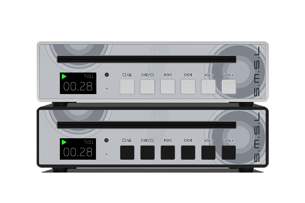

SMSL VMV PL100 CD player £110
it's the black one.
It seems highly unlikely, but I have seen issues with other hardware that appeared to only affect a specific SKU or if it was manufactured on a specific period of dates (for example, the launch PS4 had issues if the sticker indicated it was manufactured in - iirc - September of the launch year).
There was some theories floating around with the SMSL AO300 that the problems with that device seemed to be more prevalent in one of the finish options vs. the other. It's possible this is the case here, too, but I am skeptical of that.
I can say that the one I received was supposed to arrive at the end of January, but despite it saying it was shipped, the retailer never shipped the item (and they were out of stock when I inquired about why the tracking hadn't progressed in 10 days), so I had to wait until they got more stock in mid-February. It could also be that the first production run has this issue, and my own unit was made at a different time period (i.e. maybe SMSL got a bad batch of CD drive units, and were unaware of the problem).
i know :)
they are ok if you press with a thumb.
but if i use an index they get stuck almost all the time in one corner.
