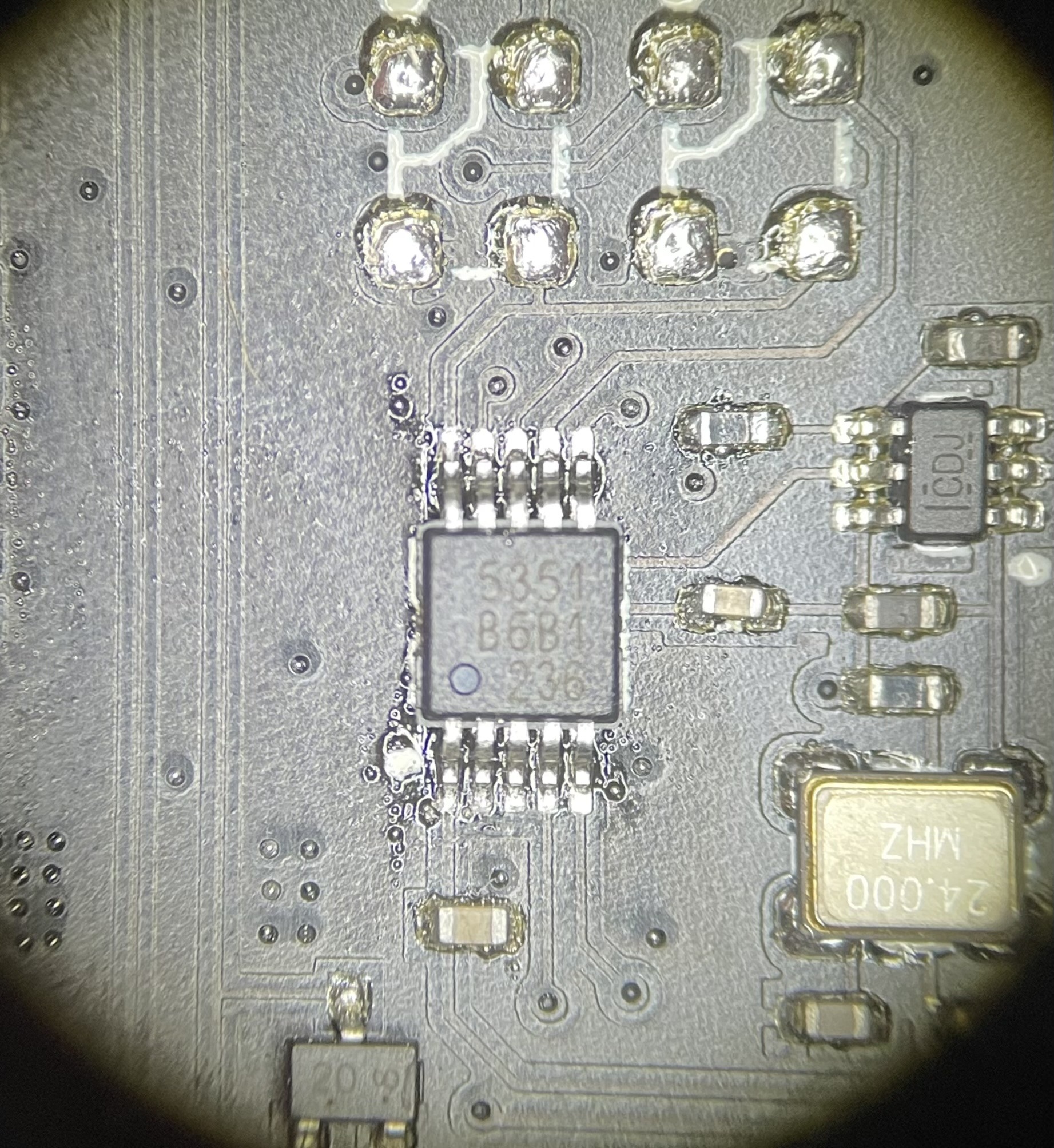

I had my SU-9n on since May 2022 and about a week ago, it started making static noises and popping sound plus really distorted sound. I thought it was my amp failing at first but changing to another DAC (Khadas TB-1, iPhone dongle) the noise went away. Turning it off and letting it rest and turning back on seems to work for a few minutes but it seems to be a thermal issue because as it warms up, it gets worse until unusable. This happens to both the SE and balanced outputs and at both 96kHz and 192khz rate USB input. I suspect there is a part inside that has failed due to aging and thermal stress. Anyhow, searching for similar issues by others have led me here. Sounds like some people have not had any issues but many people in other threads have described this very issue. Kind of a pain because I really liked the balanced out capability.

Hi xrk971, I seem to be having a similar issue to you. I purchased this in Feb 2022 from ShenzenAudio and this just started happening. I can confirm that it seems to be thermal related. The noise triggered overcurrent protection on my A30 Pro so I've switched back to using my Schitt Modi DAC.

There is a thread on DIYA where the OP shows how to fix this. I followed it and it works fine now. You need to know how to remove and install a small SMT IC chip with a hot air pencil. I can confirm that the fix is good and has been working for over a month now. Here is my installed new timer chip.

Is this a design flaw that should be proactively repaired, or a dead chip? I have a pair of SU-9ns that I would like to have in service for a long time, and basic soldering skills.
