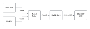

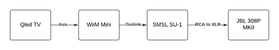

I have a question, how can I connect them?
SMSL SU-1 + wiim mini + 1 pair of jbl p308mk2 studio speakers + Qled TV .:rolleyes::rolleyes::rolleyes:
A few options:

Thank you for your answer.
I have a question. Can RCA - XLR be an alternative to RCA - TRS?
The JBL has a TRS input on the back.
Yes, TRS and XLR can be used interchangeably.
However, the cable in your picture uses TS instead of TRS, which may result in mains hum and other noises.
