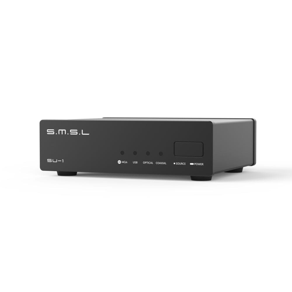

This is a review and detailed measurements of the SMSL SU-1 stereo USB DAC. It was arranged to be sent to me by shenzhenaudio from the company and costs US $79.99.
Despite its simplicity, the SU-1 manages to look elegant with nice fonts and LED indicators for different inputs. Back panel has the basically what you want:
My usual minor gripe applies here with right channel RCA not being red although in this case, it is easy to turn the unit around to plug in the cables. A USB-A to USB-C cable is provided. Note that you need to have a USB power supply even if you use non-USB input (it is the only source of power).
