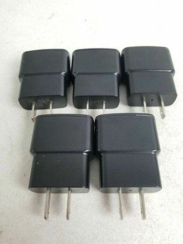

I use these since they measure as well as the Apple charger and you need to take those apart to find out if you have a fake one. No rash of fakes for the Samsung. They just work great with DACs like the E30 where it gets at least the power supply away from noisy USB ports. I've sold 8-9 E30's and bundle them in with it. Nice cheap, quiet noise floor with the ETA0U60JBE
