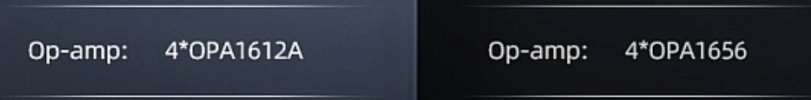

It looks like PS200 is equipped with OPA1656, a FET input, very low noise and low distortion op amp. In some circuits (source and feedback network impedances higher than ~ 10k, etc) it is preferable to OPA1612.

The ESS DAC being the same, the main difference is with the OPA1652 and OPA1612. From the respective datasheets of these, the below comparison graphs tells us more about their respective performances:
I think there is a mistake here... We are talking about the Opa1656 and not the 1652.
The Opa1656 is a higher-grade (than the 1652), more powerful revision featuring lower noise, faster slew rate, greater bandwidth, and higher output current, while the OPA1652 consumes slightly less quiescent power.

Regarding the choice of op-amps, the OPA1612 is now used everywhere because it boasts excellent specifications.
Personally, I would have selected other models, but the device's retail price would have doubled (the OPA2156 for the I/V stage and the OPA2211 for the LPF stage). ->
