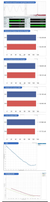

1W in 32ohm with low distortion also isn't bad (bottom plot).
In E.U. this PL200 costs € 740.-
I would need a load to test headphones output. Maybe something to consider in the future.
I already commented rest of the measurements above. They unfortunately deviate from @amirm’s standards, so are not comparable.

Here you go with the de-emphasis test as I can (will) perform it:
These two curves are the same, one has the pre-emphasis flag "ON", on the the test CD. So if the CD player does not decode, the two curves will overlap. If the player decodes the Pre-emphasis flag and applies the correction curve, I can verify the compliance with the expected one.
So I'll include that test in my future reviews, and I might just say that it decodes and the measured deviation at 11kHz, I suppose it would be enough. I'll update the initial post with that.
For fun, this is the same with an overlay of the OPPO BFP-105 results, of which review is cooking hot:
And so for the OPPO and the SMSL, I can summarize by:
  • De-emphasis compliance (deviation at 11khz) : Yes (0.0dB)
