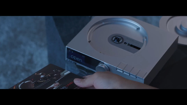

SMSL PL200 - Presentation
Released in 2023 and hosting an AK4499EX, this CD player intends to be a high-end one. There a transport only version of the same called PL200T.
Besides the top loading mechanism, this CD Player offers the below features:
  • High-res DAC from AsahiKASEI with THD+N = -124dB / 0.0000631% / SINAD 124dB
  • 5 selectable filters:
    • Sharp (Default)
    • Slow
    • Short Sharp
    • Short Slow
    • Super Slow (aka NOS)
    • Low Dispersion
  • Four selectable "Sound colors" which I understand allow to change the delta-sigma oversampling rate, and as per my measurements:
    • SC1 (5.6M) : Lowest Distortion, noise shaper kicking off at 30kHz (Default)
    • SC2 (5.6M) : 10dB more distorsion than SC1, noise shaper kicking off at 80kHz
    • SC3 (11M) : 5dB more distortion than SC2, noise shaper kicking off at 110kHz
    • SC4 (11M) : No measurable difference (up to 380kHz) with SC3
  • XLR and RCA outputs
  • Headphones output (on the back, unfortunately), with selectable low and high output
  • Volume control
  • USB input up to 32bit/768kHz, DSD512
  • Bluetooth LDAC (24bit/96kHz), APTX/HD, SBC, AAC
  • It is truly gapless playback (whatever button you touch :p )
The back of the unit is busy, due to the size:
We get big fat Canon XLR outputs, together with unbalanced RCA. We also get two SPDIF digital outputs, one headphones (unbalanced), the Bluetooth antenna and the USB input to use it as a DAC. It requires a socket wall, and I would have loved to be able to use it from an external battery, like the SMSL PL150.

Cherry on the cake, and this is a personal note: I know some of you find the top loading an odd thing from the past, but I love that. It makes me interact more with the media that I've been enjoying since 1983 (my 2 first CDs where Michael Jackson - Thriller and David Bowie - Let's Dance). And by the way, yes, I still love to spin a good old low-res record, I have so many. The SMSL makes me enjoy a similar pleasure and it's small enough to fit besides my turn table.
The pleasure to use is way higher than with the OPPO, on my perspective. So that's a big winner that I can only recommend as you would have guessed.

Hard no. It's got bits that you can lose or break which are separate to the unit itself. Crap design.
A lid on a hinge, wonder if they've been to that part of the design course, or just got hired before they'd finished.
No thanks.
Good review tho.
