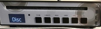

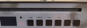

Got an SMSL PL100 from Amazon Germany today and unfortunately it turned out defective. Out of the box it powers on and accepts discs, but it simply won’t play.
Here’s what I tried:
- Multiple discs (both pressed CDs and CD-Rs).
- Different power supplies, including a brand-new Raspberry Pi 5V/3A USB-C PSU.
- Standalone use with headphones.
- Connected to an external DAC.
The behaviour is always the same: the player spins up, the display shows “Disc” then “Read”, so it’s clearly attempting to access the TOC. But the moment I press Play, the display shuts off completely and only the red LED stays lit. No track info, no playback, no audio output of any kind.
Amazon initially asked me to get a return shipping quote, which came out to over €90 just to send it back. In the end they skipped the return process, refunded me in full, and told me to keep or dispose of the unit.
Overall, a weird and time-wasting experience. At least I didn’t lose money, but given that it failed straight out of the box, I’m not impressed. Sometimes you really do get what you pay for.

Maybe try to check if the cabling inside is well positioned on the pcb connectors?

I would check the cabling inside too. Good point.

No, I'm located in the Middle East. I’ll check the cabling and provide an update if there’s anything of interest to report. However, I have no idea how to open the housing to access the internal components. There are seven screws on the back panel that look like Torx type, but I’m really unsure how to proceed or where to begin. Thank you.
