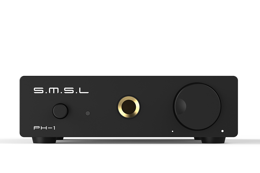

This is a review and detailed measurements of the SMSL PH-1 Phono Stage and headphone amplifier. It was sent to me by Aoshida Audio and costs US $70.
The volume for the headphone output was very shallow and difficult to rotate. I did not measure it. The rest of the box looks fine with a fixed gain and simply on-off switch in the front. Let's see how it measures.
The unit is powered by a barrel connector. A USB to that connector is supplied and that is how I tested it.
