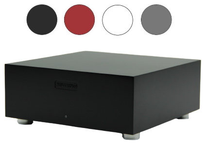

https://www.audiophonics.fr/en/powe...tereo-ncore-nc252mp-2x250w-4-ohm-p-14278.html
(also available in XLR version)
Both have confirmed to be using last year's updated and slightly improved NCx252MP board (coming from NC252MP)
