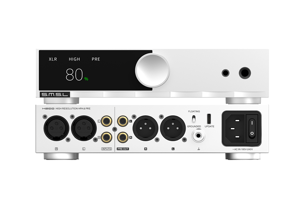

This is a review and detailed measurements of the SMSL H200 Preamplifier and HP Amplifier.
It was kindly sent to me by SMSL, on my request, and I received a very early production sample. Current price is below $400.
Presentation
The SMSL H200 is a pure analogue preamplifier, some sort of dinosaur in our digital world, and now addressing a niche market(?). It offers only two inputs (Balanced and Single Ended), with two rear outputs (XLR and RCA) as well as two front balanced and unbalanced outputs too for headphones.
Rear inputs must be selected from the menu, making it a 2 inputs preamplifier, again one being balanced and the other unbalanced. Both rear outputs will route the signal when they are active, else it goes to front output, meaning there too you have to chose between line or headphones outputs.
This device integrates well in the "200" series from SMSL where we find notably the PL200T, D200 or G1 that I already reviewed.
The back is as simple as it can get, but not the USB input for potential updates :
You can get more details about this device from SMSL themselves who announced the release of the H200 here on ASR.
User experience
The interface is simple, and serves to select the input (RCA or XLR), and outputs (rear or front). There's one addition and that is the gain which is selectable between High/Mid/Low and it impacts rear outputs too.
There is a remote control that repeats all functions available from the front knob, but I did not use it.
Basically, we have only two analogue inputs, one Balanced and one Single Ended. This is not much, but in a digital world, the DAC is likely to be the real source selector. No phono input here.
Looking at it from far away, it looks like you get only a volume knob, especially if you think about it as a preamplifier. But it is a little more than that. To start with, the analog volume is digitally controlled to offer perfect channel balance, and a significant part of a preamplifier’s performances rely on the quality of the volume knob.
What's interesting too is that we get 3 selectable gains that influence the rear outputs too. You are used to the "Low" gain setting which is useful for sensitive IEMs to increase the dynamic range by lowering the internal gain of the amplifier. It means you'll need to crank up the volume by several notches, and that's the purpose so as to increase the DR. I measured them (from XLR input) as is:
The reason I'm mentioning this, in the user experience section of the review, is because it is practical to get selectable gains at the output. Indeed, and similar to the IEM reasoning for wanting low gain, I do like to have high gain at the output so I can use older devices such as a Cassette Deck but also some older CD Players (HDCD ones are often limited to 1Vrms when not playing a HDCD disc). These older devices can go way below our standard 2Vrms output, let alone 4Vrms from XLR, but modern amplifiers are in demand of higher input voltages. So having a "high" 14dB (RCA) or 20dB (XLR) gain at the output of the preamp will help drive an amplifier to its max power with low output voltage sources.
On the contrary, having a "Medium Gain" choice helps with high output voltages sources and amplifiers that can be driven to full power with input voltages below 1Vrms. Again, the idea is the use the volume as close as possible to the max so the dynamic range is better. We'll see if that theory translates into measurable advantages.
The H200 gets warm rapidly and can run hot if outside temperature is too (no measurements, sorry).
The volume display does not show the standard attenuation in dB but a rather unusual % of maximum, from 0 to 99%. I could hear some light relay sound when going one level up or down.
Presentation
User experience
- Low Gain : -3.8dB gain (claimed -3.8dB)
- Medium Gain : 5.5dB gain (claimed 6dB)
- High Gain : 19.13dB gain (claimed 19.7dB)
