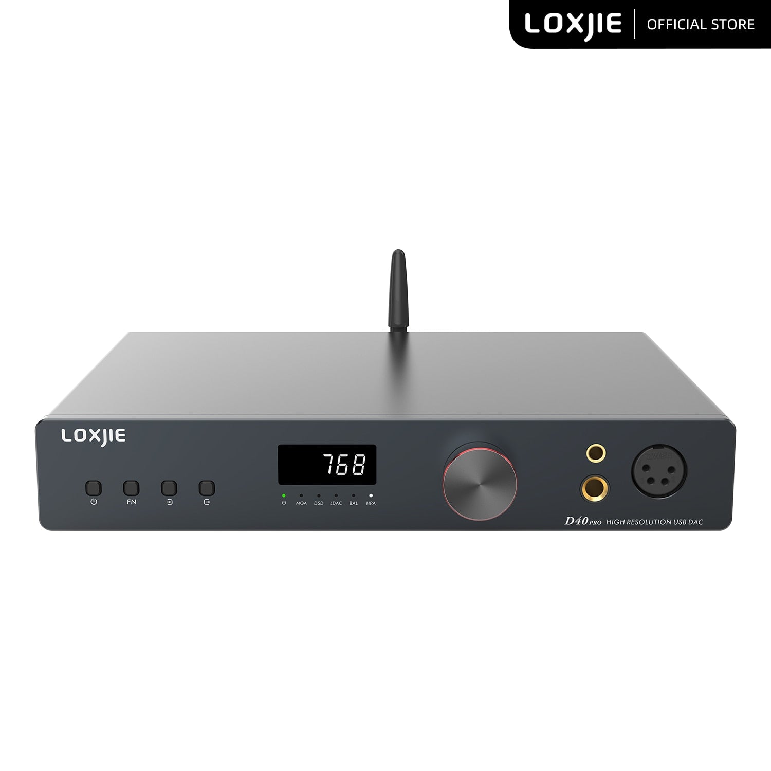

When you think about it... the Loxjie D40 Pro cost $285 and offers exactly the same performance as the SMSL DO400... There's absolutely nothing revolutionary here except for the price rip-off.
PS : check the PCB pictures they are quasi identical.

Nice, thank you for the information, and I ordered the Loxjie as an opportunity for me to check how far my little analyzer is from the big AP ;)
Awaken your consciences, friends...
Yeah. That's why DO400 doesn't make sense nowadays ngl. Unless one absolutely needs the display and better aesthetics, I don't think it's worth paying the extra 100+ USD (vs Loxjie D40 Pro) just for these things.
Nonetheless I'd still get the DO400 over the DX5 II (maybe even at the DO400's pricetag lol).
