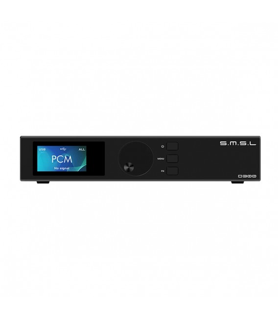

This is a review and detailed measurements of the SMSL DO300 balanced stereo USB DAC with Bluetooth. It was sent to me by the company and costs US $549 although I see it on sale for $490.
The DO300 naturally follows the design language of other recent SMSL products. I like the colorful display and largish displayed volume level. Back panel doesn't provide any surprises:
A minor nit: I like to see color codec RCA jacks with red indicating right channel. Looking from above, it is hard to know which channel is which. I like to see trigger support to sequence powering on downstream products as well.
