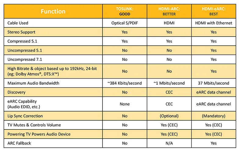

ARC only supports around 1.5mbps - or CD quality!
eARC supports a lot higher bandwidth: "With its 37Mb/s bandwidth, eARC can carry up to 32-channel audio, including 8 channels of 192 kHz and 24-bit uncompressed audio. It also supports modern advanced audio formats like DTS-HD Master Audio, DTS:X, Dolby TrueHD, and Dolby Atmos. In comparison, HDMI ARC only supports up to 6-channel compressed audio and has a maximum bandwidth of 1Mb/second. It supports different audio formats like PCM (2 channel), Dolby Digital (up to 5.1 channel) and DTS Digital Surround (up to 5.1 channel)."

Yeah 16 bit 48khz appears to be the max speed per HDMI ARC spec. My LG TV forces 16 bit 44.1 PCM stereo over ARC on the SMSL, but does 16 bit 48khz PCM stereo over optical.
If I use an ARC/eARC extractor I get 16bit 48khz from the TV though, which is weird.
