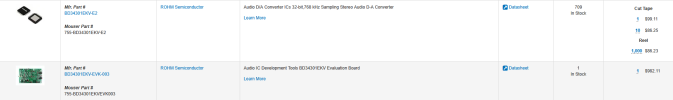

Based on the prices here on Mouser; the ROHM DAC is $20 more than the most expensive ESS DAC that you find in expensive high end DAC's.... the mid and lower range DAC's all use the Q2M versions (which are all under $20.... most under $10).

Sure any back channel deals can be made, but places like Mouser usually have prices quite similar to any other bulk rates available (as they also sell bulk and there are plenty of companies that buy from them).
It would make little sense though that ROHM chips are so expensive in the "end user" market but so cheap on other markets and then at the same time have no manufacturers using them.
I'd be glad if you can show me somewhere that the ROHM chips are indeed cheaper. If you are a manufacturer; then reach out and see what price they give you so that we can put this debate to rest.
To me it seems like this chip is just way more expensive than others; which goes along with why it isn't used in basically any designs.
I've been following it for years (and one of my friends bought a ROHM DAC portable) and while the performance is good; literally no companies use it and it only appears in $400+ products (with the SMSL Design being the cheapest one). At that price point it isn't competitive and I would say they would need to beat the price of the AK4499EX considering the performance offered.
My guess is that the mouser pricing isn't so far off reality (just like I have seen in other scenarios) and as such companies don't want to develop a new design when the chip isn't cheap. CS43198 has a million designs because the chips are cheap and quite performant.... so every day people are making new designs using this chip.
