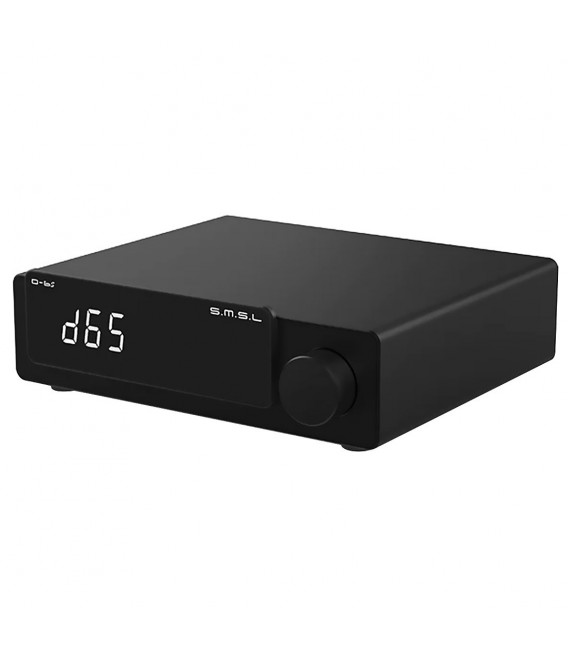

In a desktop pc system, with a NAD C316Bee class AB amplifier and a D6S dac (usb connected) to the computer, where did I turn their volume (dac & amp) for everyday use, low or high volume? I listen by Spotify & Tidal
Now I have dac's volume in -93 and I use the amps knob for up and down. Is that right?
You could further increase the volume on the DAC to 95 which is 2 V RMS output for a 0 dBFS input. Going above that above may overload the input of the amp.
