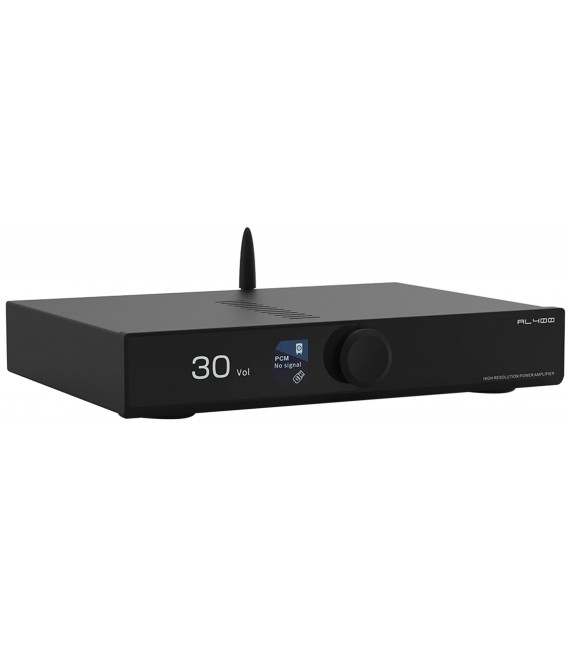

SMSL also jumps onto TPA3255 amp space now, quite a package of features in this small unit:
Note- They haven’t mentioned PFFB, so it’s unclear but possibly not deployed.
Frequency response graphs aren’t available as well.

Nothing really new; these devices were already available as the SMSL AS400 and the Loxjie A40, both featuring the Infineon MA5332MS and NJW1194A.
It would be nice if they managed to integrate the TPA3255 better than the TPA6120a2, but the measurements will show that.
In any case, it's an alternative to the Infineon amplifiers.

I hope you can help in finding couple of answers for us, these are kind of common questions on TPA3255 based amplifier here:
1) Does AL400 use PFFB circuit?
2) Do you have frequency response graphs for 4 & 8 ohm loads?
3) What is output impedance of AL400.
BTW, I did reach out on FB asking same questions (first two questions) but don’t think those were answered there.

Hi,
Here are a few clarifications:
  1. The PFFB implementation details are not publicly disclosed.
  2. The updated frequency response chart is now available.
    You can view the full measurements here:
    https://www.smsl-audio.com/portal/product/detail/id/935.html
  3. The damping factor of the AL400 is 74.
