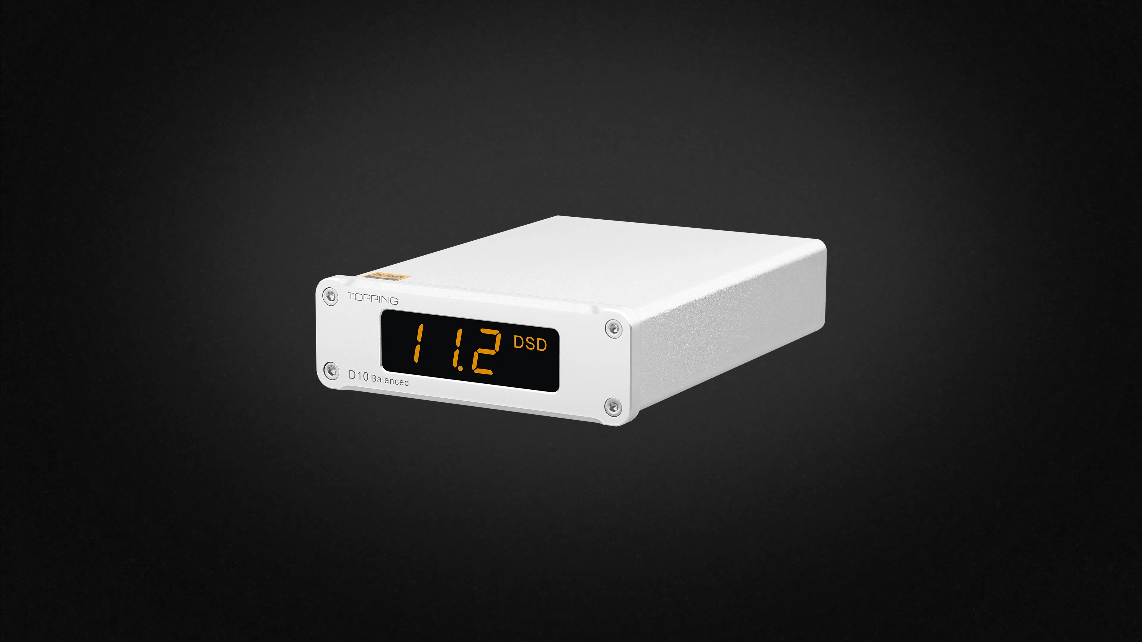

Topping D10 Balanced doesn't require external power and has standard TRS balanced outputs.
Requires external AC power.
