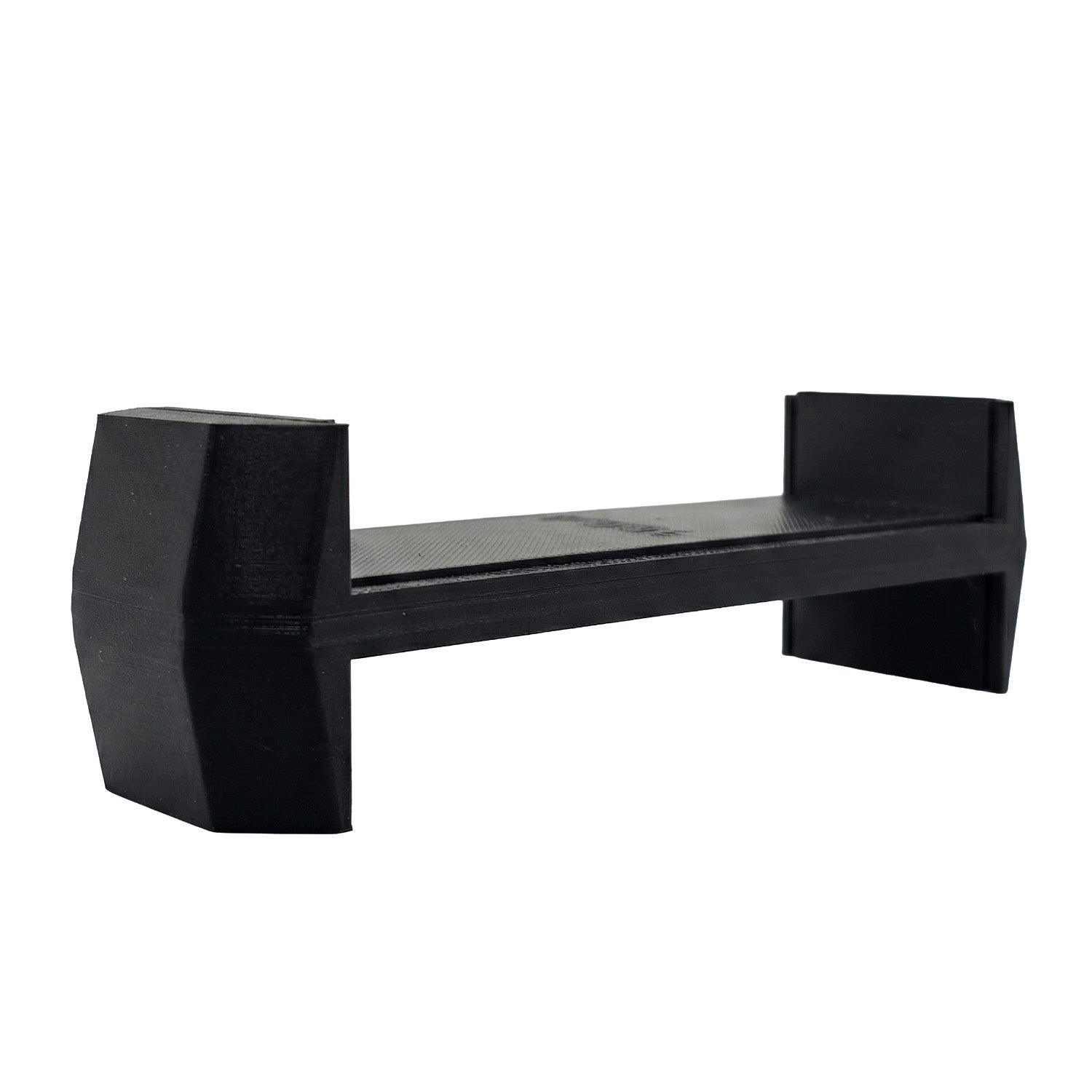

So, working on a solution to allow you to stack the Inkognitos in the vertical position, because why not. :D
This is a quick picture of a prototype only so far, but looks promising. Between each sub there are two tie-fighter shaped brackets that fit snugly to both subs. So you push two of those down on top of a sub, and then slip the next sub on top. The insides have soft material that both absorb vibrations and ensure the paint isn't damaged.
With two subs it's pretty stable. If you want three on top of each other, the feet at the floor probably needs to be more of an outrigger style, so that's probably the next iteration. :)

Stacking kit now available! Not something I expect to sell bucket loads of, but a very neat solution for those interested in this. I'm considering to implement this myself in my dedicated listening room. The Manta with two Inkognitos in this configuration behind each speaker, resulting in 3x12" on each side (including the 12" in the Mantas). :)
