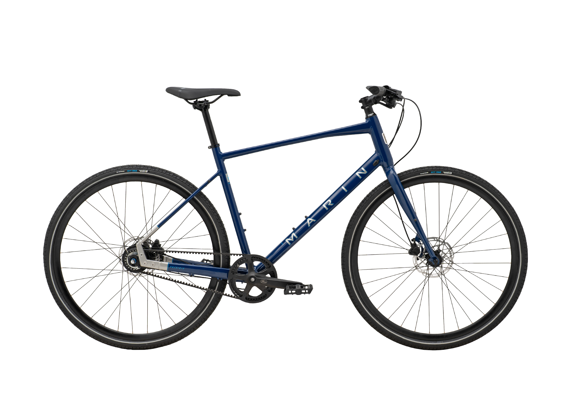

Following your same concerns, I got my son a Marin Presidio 3. Belt drive, 8 internal gears, puncture resistant and reflective tires.
