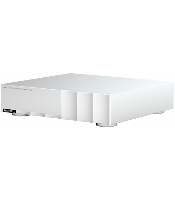

Shenzhen SIAS SMSL announce their new Clock G1
oberon
Dec 25, 2023
7
7
SMSL claims that clock will bring a larger sound stage and increase resolution.
Price is 2999 RMB
SMSL claims
