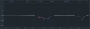

Based on the review of diy heaven i used this eq which for the moment satisfies me, i'd be glad to see the eq suggested by Amir
