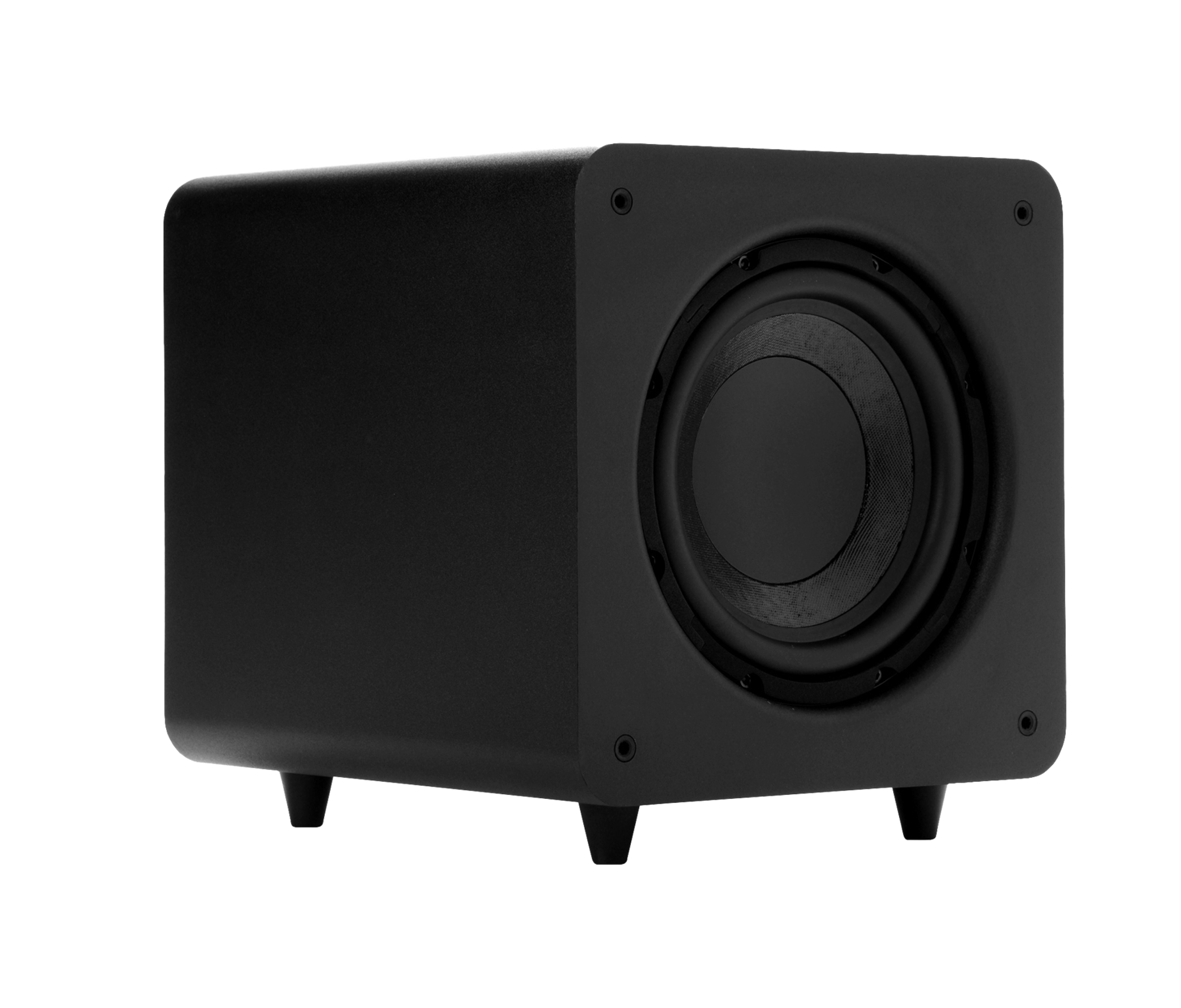

Paradigm Essentials Sub 10, remove the feet and use smaller rubber pads to gain the 1cm too tall, the feet are about 4cm. I am testing for our company right now. I was playing and did some in room comparisons at 1/3 octave intervals. Weather is not permitting for ground plane outside, so use this as a relative measurement as values will be high. I compared the measurements to a Kali audio WS-6.2 which is too big for your situation but I consider one of the better small subs for its price. I've used the Kef Kube 8 and its performance would be as good as the Paradigm. But it would also be a good choice for your size. Although the Kube 8 does have a lot nicer finish if it was being shown, definitely a good lookng sub. Another consideration might be the SVS SB-1000 Pro without its feet. That is a 12" woofer so should perform well. You would have to call them and get its dimensions without feet.
