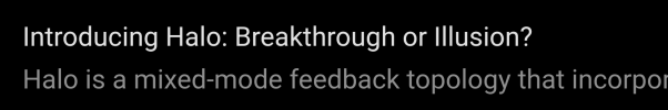

@amirm can you test the difference in distortion and frequency response between SE and XLR 4 with say ... the HD650, which has a varying impedance, as an actual load in parallel to the AP on 200kohm ?
Requires a splitter and having both XLR and TRS jack Sennheiser cables.
This is when the XLR outputs are supposed to differ and would actually be showing the effect of the 'Halo' circuit. (THE feature of this specific amp)
With a resistive load or planar like the Stealth the differences (at least in FR) will probably be smaller.
You could be the first to show what that circuit does. :)

Besides they want feedback on the 'Halo' thingy which the Magnius can't do.
Basically the Midgard is a (discrete) Magnius with the extra 'Halo' feature for people owning balanced headphones.
