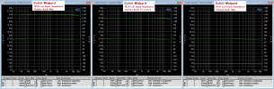

Sorry. I didn't provide enough information about the RCA input impedance.
It was about 9.5 kohm at maximum volume and about 45 kohm at minimum volume. I will post the measurements later.
I measured the Schiit Midgard with XLR input / RCA output / Low Gain settings. I added High Gain to the AP Dashboard and THD Level Sweep.
I have previously posted about the power consumption, and temperature.
It seems like it could be used as a converter with little signal degradation when you need to connect a differential output to an unbalanced input.
For the reverse conversion, no active converter is required; a suitable conversion cable is sufficient.
Incidentally, the Douk / Nobsound NS-05P PRO is similar.
This one has more noise, less harmonic distortion, the power supply is sold separately, it can be easily powered by batteries, it's one-third the size, and the XLR-RCA and RCA-XLR can be used independently (can also use it as XLR-XLR or RCA-RCA if connected in series). It costs $60.
