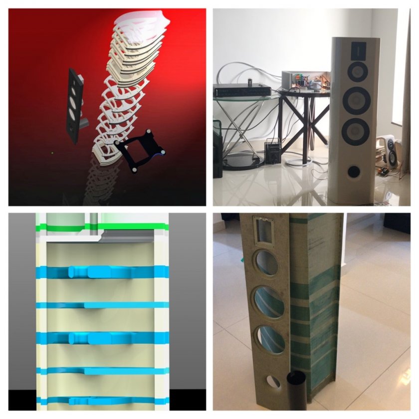

This tweeter concept is something different. My involvement has not been requested.
Good to know.
Glad to see you here. I remember Dennis was excited about your speaker concept, but I haven't heard anything lately.
