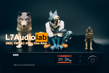

This is what I said )
Additional measurements of the A2 :
