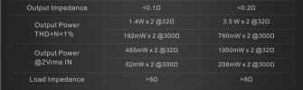

According to the manufacturers info the 1/4 is not balanced and the 4.4 is.
Link
The XLR output on the back is balanced, the 4.4mm headphone output on the front is just for convenience and is not. Sabaj would quote separate power outputs for 6.35mm and 4.4mm if the later was balanced.
You suggest this is incorrect?
Yes, the picture shows a 'balanced' connector, i.e. a 5 pole 4.4mm 'pentacon' plug. But this is just for convenience for those like myself who have headphones/IEMs with this connector (my Sennheiser HD 660s come with such a cable).
If you look further down the page, you will see that no distinction is made between power output for the different connections...
Contrast this with the specs for an HP amp with a truly balanced output like my Topping A50s...
(table truncated as it's too big!)
From: https://www.tpdz.net/productinfo/12431.html
My Topping EX5 DAC/Amp is similar to the Sabaj A20d in that it has a balanced headphone connection (XLR in this case) connected to a single ended amplifier inside the unit (so the power output is identical to the 6.35mm (1/4") connection)
Thanks, I get it. Pretty misleading picture imo...
