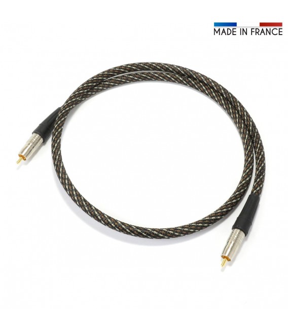

Is this a good digital coax cable for connecting it to my DAC? The connector outside looks bad isolated.
Both the Canare L-5CFB cable and Canare C5F connectors are advertised as having true 75 ohm characteristic impedance, so this should be a good choice.
