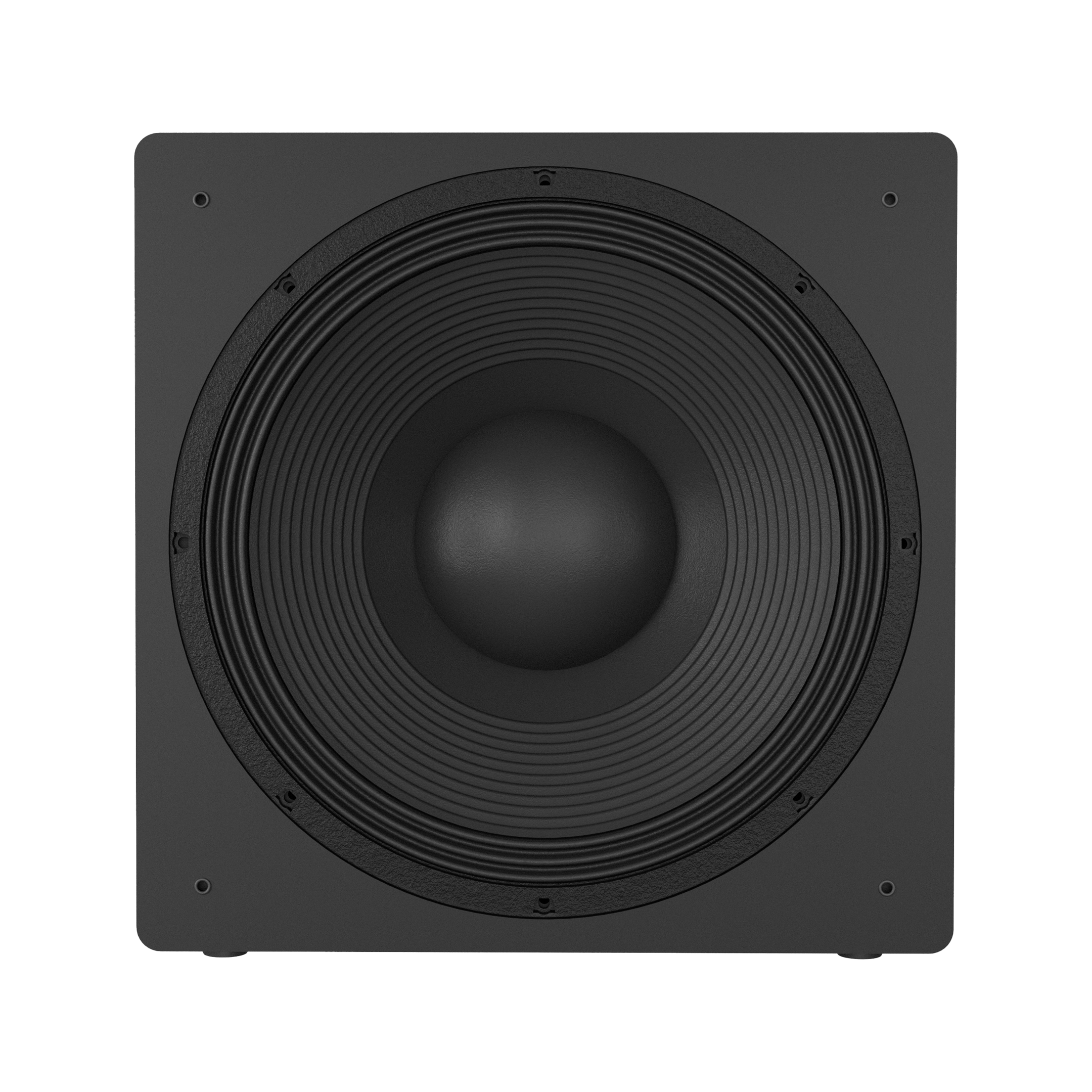

So, I'm looking to replace my PSA s1512 with one of these two subs...currently.
I have two FV18's in my home theater set-up, so I'm familiar with the performance of the vented version of the F18, and there are independent measurements available...so I'm more or less confident in what I'd be getting. However, I am intrigued by the PSA S2112M. The s1512 has been a solid sub for me, but I just want the ability to go lower (pipe organ). There is just something I find compelling about having a 21" sub in my two channel set up. My MoFi V10's are already enormous, and having an enormous subwoofer is just...appealing.
Anyway, the issue I'm having is that I've not been able to find independent measurements for the PSA, and was just wondering if someone owns one, or has better Google-fu than I do. I have looked into JTR, as well, but I'm not sure I can justify spending twice as much chasing the bottom ~18hz in my set-up.

Data-Bass may help. Both the the FV18 and F18 are tested, and DIY subs with B&C 21" drivers are also tested.
I'm not clear which B&C model PSA uses, but we can get a ballpark estimate of what a 21" prosound driver in a sealed cabinet can do compared other systems.
You can compare various tests, for example the FV18 compared to a B&C 21SW152 in a DIY sealed cabinet:
And a spreadsheet of tested systems that can be filtered:
Rhythmik are near the top of the sealed and of the vented systems of output.
If you can only have one sub and want to play organ music I would recommend going with a large ported enclosure. Giant drivers in small sealed boxes are OK but you leave A LOT (~10 dB) on the table compared to a 21" in a proper size ported enclosure.

In a way they have. This is the near equivalent of the PSA sub:
A B&C 21" Neo driver in a small closed box. PSA adds a Hypex plate amp, so you can EQ to your room and system. But the driver performance will be roughly equivalent.
We can compare the Rythmik FV18 and F18 to the B&C 21" in sealed and vented boxes.
For example CEA-2010, not that that tells everything about the systems... ;)
The differences in sealed below 30Hz is negligible. Maybe servo makes a difference here. Obviously the B&C sealed needs the room and some EQ to work.
The Rythmik FV18 doesn't have the max output of the B&C vented, but does well below 20Hz. I guess I'm not surprised given the intended use of the B&C driver. And this is just one metric of output.
For my uses, 4x of any of these four systems would make me very happy.:cool:
