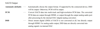

Per the user manual:
Set the Optical output to 48K or 96K LPCM and you won't have to manually alter anything.
Though keep in mind that, according to the manual, the UDP800 will play back SACDs only via HDMI and analog out:
Good catch Static! For the UR solution this eliminates SACD playback.
