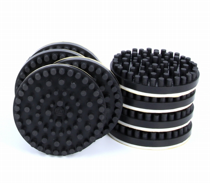

Try these, usually sells for 10 euros for 4 (can be called lucid,tonar,dufray,facmogu,Kwmobile but they are the same)
One thing you should be aware of when taking of the protection for the adhesive buttom, once you get it on the speaker,sub,tt,amp what ever you wanna use it for, you will only get it of by damage it, so make shure it sit in the right place, shouldn't cost more then 10 euros for a set of 4 feet, don't pay more
