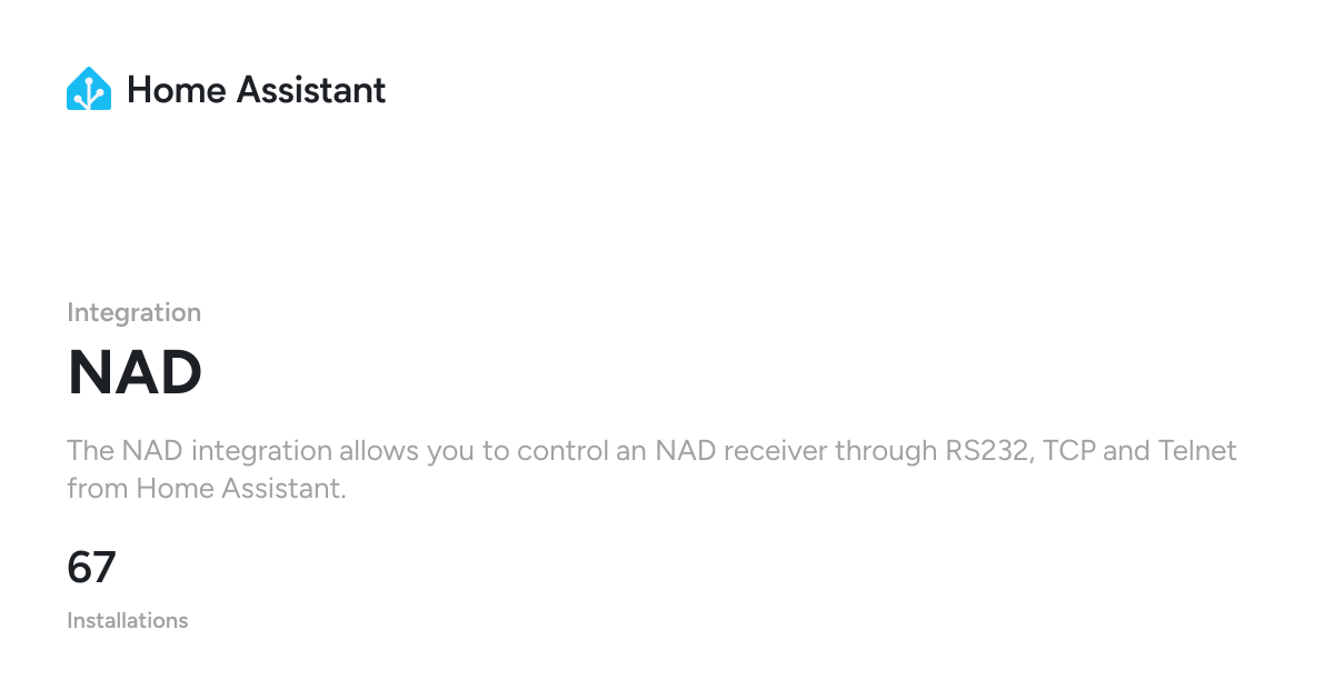

With a bit of luck you don’t need to buy anything. The same protocol is likely available over TCP as well. If you have Home Assistant you can try this:
It sound more complicated than just using rs232 to usb cable and something like putty ?
I just want to disable the max volume limit in the Amp menu.. And if i do so, i will be doing it blindly because i have no osd on the pc ? Or is there perhaps an easier way ?
Putty can be used over TCP as well. The protocol seems ASCII based, so a simple telnet client (like putty) should work:
