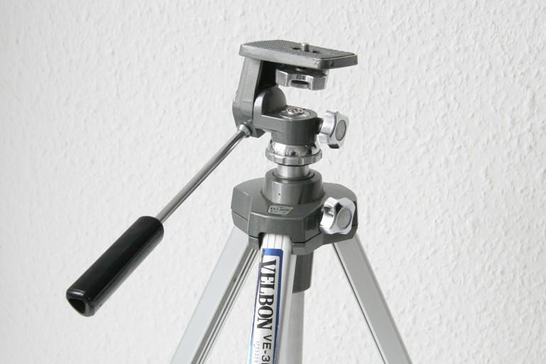

I have been using an ancient Radio Shack sound level meter with an analog output and want to get a better mic. I have a few questions:
- The Dayton Audio UMM_6 doesn't seem to come with a cradle to hold he mic. What do you use?
- The Minidsp UMIK-1 is shown with a cradle on a short tripod holding the mic. I'd like to mount the mic. in the provided cradle on a camera tripod with the standard thread sizes. Is the provided tripod detachable from the cradle? Does the bottom of the cradle have a socket for a standard camera tripod screw thread?

I disagree with Ray. I have a UMIK-1, which I use with a Samson folding mike tripod with boom. The mike cradle unscrews from the supplied mini tripod, and the cradle then fit perfectly on the 2-3' boom on the Samson. I think the thread size is about 9/16 or 5/8" with a threaded barrel connector.
I had the Samson mike tripod from my old Audyssey Pro kit, which I otherwise no longer use. I think using a mike tripod with a boom is better than a camera tripod, because the boom can be swung over the actual sweet spot listening position or other seats. Camera tripods don't usually do that. I have seen mike boom stands at Sam Ash, Amazon, etc. or other music stores for under $30.
I also think a tripod or mike stand sitting on the floor is going to be less susceptible to external vibration during the calibration than sitting the tiny supplied UMIK-1 tripod on a piece of furniture and duct taping it down. You know who I am talking about, Ray Dunzi!
Also, I would get the UMIK or Dayton calibrated from CrossSpectrum. It's maybe $25 more, but you get the all important 90 degree calibration curve on a thumb drive from CrossSpectrum, plus it is an individual calibration. Stereo or Mch, you want the mike pointed at the ceiling during calibration, so most direct and reflected sound will be coming at the mike from 90 degrees.

I am thinking Ray's answer is based upon the question of using the UMIK mike holder with a photo or camera tripod. The threads won't work. The UMIK mike holder will screw off the small tripod and fit a microphone tripod. It uses the smaller European microphone threads.
I think you are absolutely correct, although I also happen to have this adapter that came with my Audyssey Pro kit that would make it compatible with standard threading on a camera tripod. But, try to find one on your own.
Bottom line. Don't use a camera tripod. Use a cheap mike stand with a boom.

The threaded hole in the base of the UMIK-1 "cradle" is larger than the threads in my standard-type Velbon VE-3 Camera tripod, which fits the hole in the bottom of my Nikon and every other camera and binocular holder I used with it.
That's what Old Listener asked: "Does the bottom of the cradle have a socket for a standard camera tripod screw thread?"
