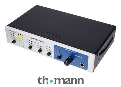

Could you confirm first that you are talking about ADI-2 FS :
And not about ADI-2 DAC FS ?
If the latter, you need yo put Auto Ref Level : Off, then, chose REF Level : +13dBu, and lock the volume at -4.5dB.
Hi. I m talking about RME ADI 2 DAC That’s what written in the product. It’s not RME 2 ADI fS. In any case I will take your point on ref and auto ref setting Thx.
